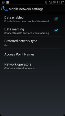

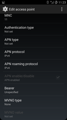

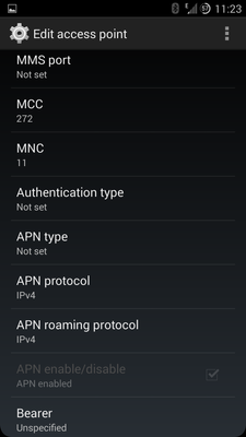

This is still working for me - screenshots attached
Crappy signal here so not many bars as you can see but I got some intermittent data! Works fine in other areas.  Picture messaging no worky but that is not a problem for me.
Screenshot_2014-02-27-11-27-10.png  Screenshot_2014-02-27-11-23-21.png  Screenshot_2014-02-27-11-23-28.png Screenshot_2014-02-27-11-23-38.png
Try using those settings, save them (obv), turn the phone off and on.
If that still doesn't work, try ordering a microsim (if you don't already have one).
If that doesn't work, I'm out of ideas

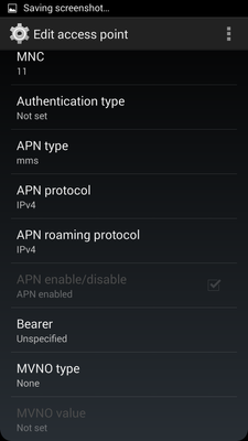

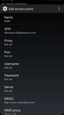

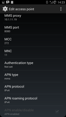

Ok, so I just got curious and added a new MMS APN (in addition to my first one, as you can see from the first screenshot below - I rebooted and happily I still have internet access on my Nexus 5!
Here are screenshots:
I can now (maybe) receive picture messages.  Will post back if I ever get one and it works (or doesn't)
