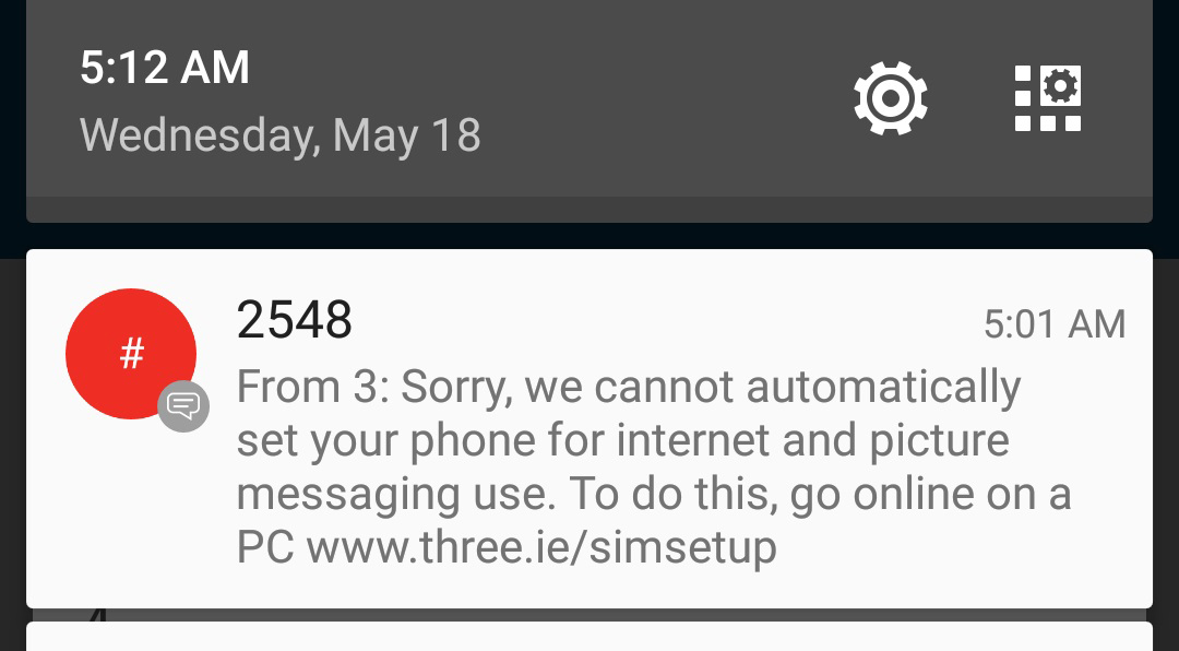

I tried a factory reset - nothing to lose. When it was all done resetting I inserted sim. still no signal but I did get message from Three - Not sure what to make of it. (I still didn't have signal bars - couldn't make call or anything)

What SIM did you insert when you got that message from 3?
If it was the 48 SIM then I don't know why you'd be getting any message from 3.
However all the message is saying is that they cannot automatically configure the internet/APN settings so you need to do that yourself - see here:
http://community.48months.ie/t5/Need-Help/Internet/m-p/34493#M12560

What SIM did you insert when you got that message from 3? I factory reset and then inserted 48.- after a couple of minutes the 3 messahe arrived.

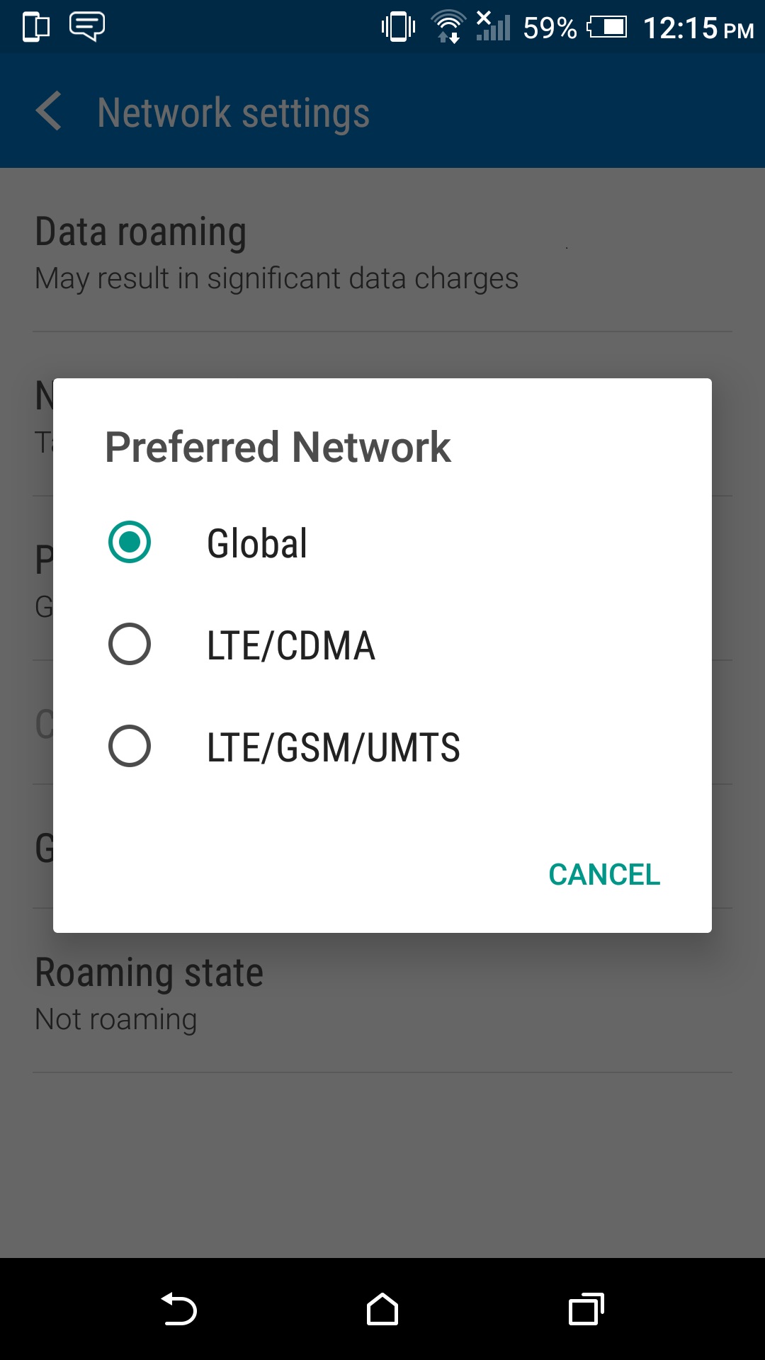

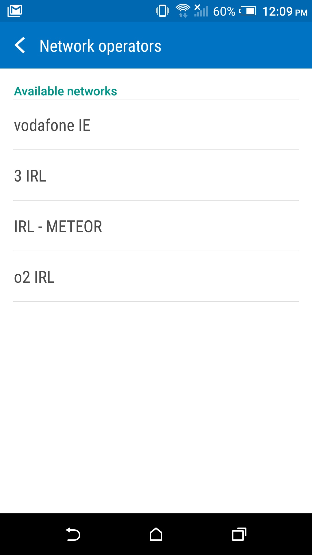

When you manually search for networks what do you see (screenshot if possible)?
When I click on Preferred Network i get a choice of 3 types. I have tried each of these with the same result - nada

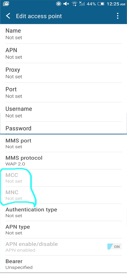

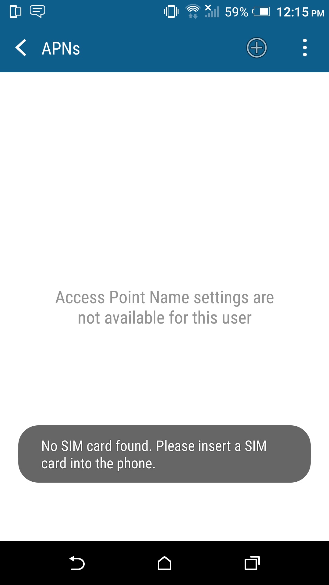

when i try to set APN I get
When I click the add button i get into the normal APN SETTING SCREEN but some of the settings are greyed out and I cant set them and it wont save without setting

Still no idea why you see 3 on the message about settings.
It should say 48...

Trying to configure the APN settings when it thinks that there is no SIM installed is never going to work - it needs the SIM to allow this to proceed.
