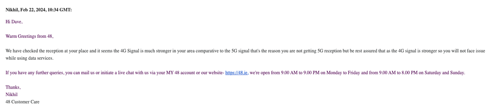

Look at this half-assed assessment from 48 Support:
I can't accept that, so I replied:
