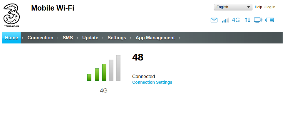

Hey, thanks for the quick reply.  Well, this is a bit embarrasing, I switch from the B525 to the E5573 in order to try out some of the stuff you linked to, only to see this;
- all I guess that was needed was to disable/restart the network connection, having first created the new '48' network profile, which included the '48months.liffeytelecom.com' APN bit.
Thanks for the help!
But it's working ok now?
If so that's great and glad to hear it.
If you change the APN settings I think you have to reboot or at least toggle airplane mode on and off.
