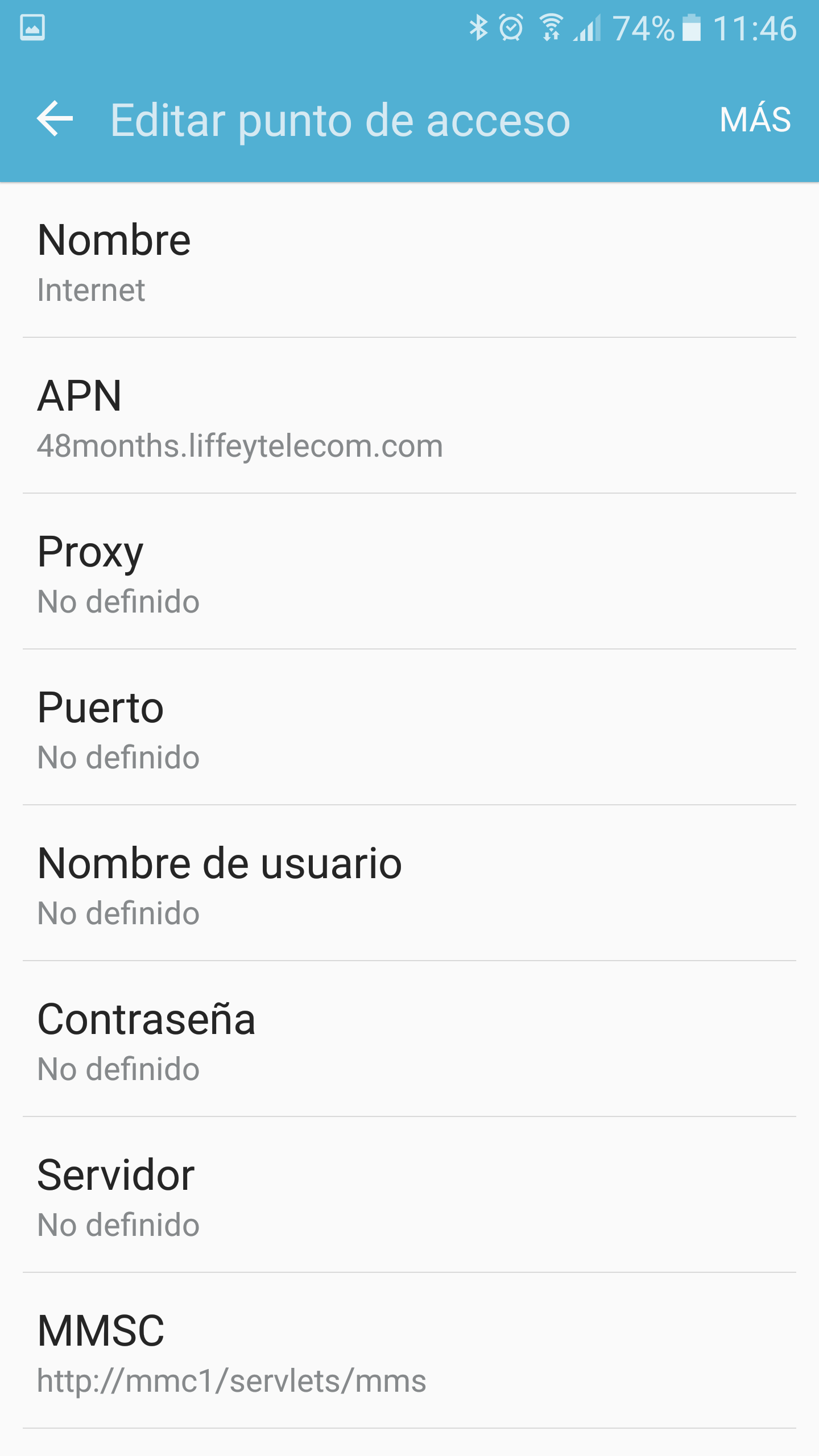

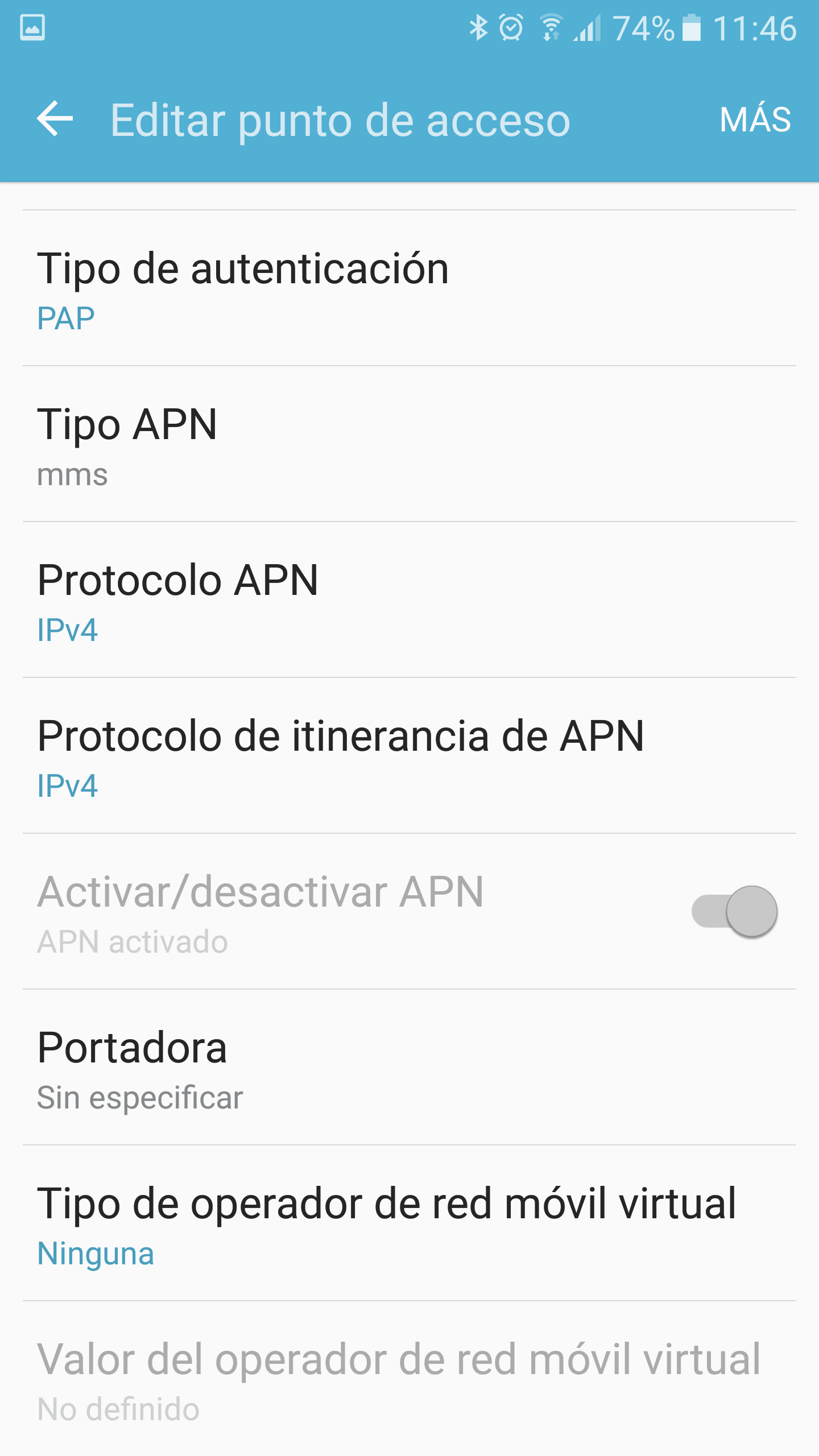

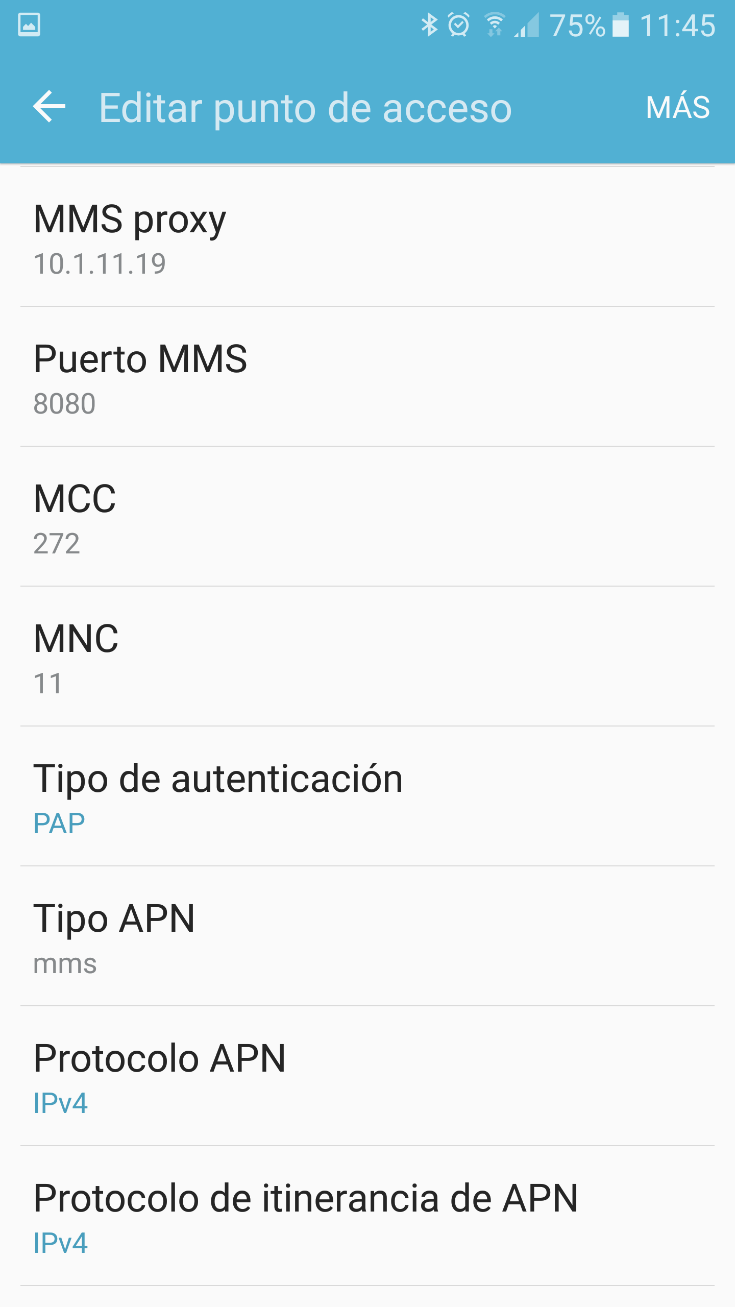

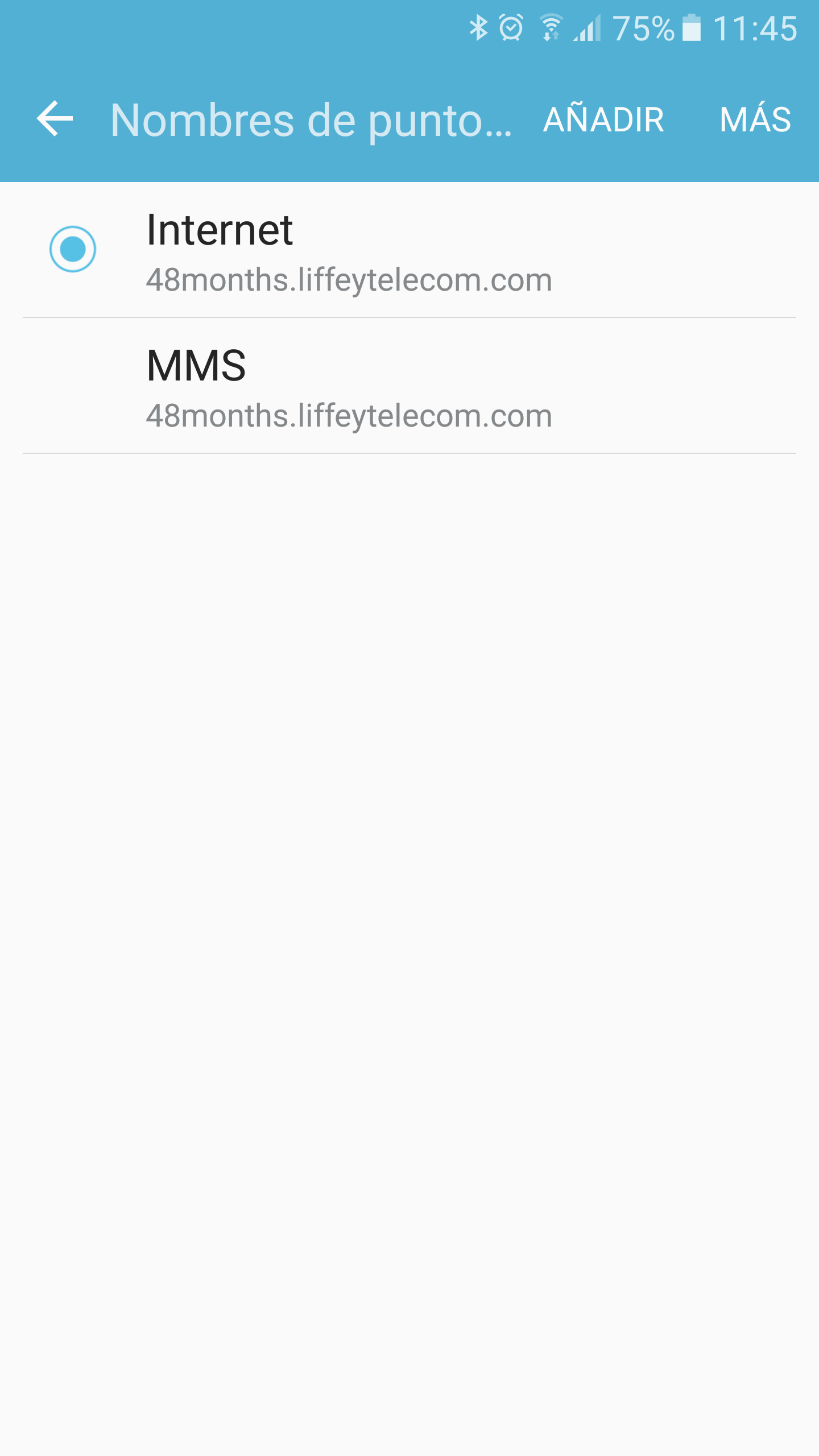

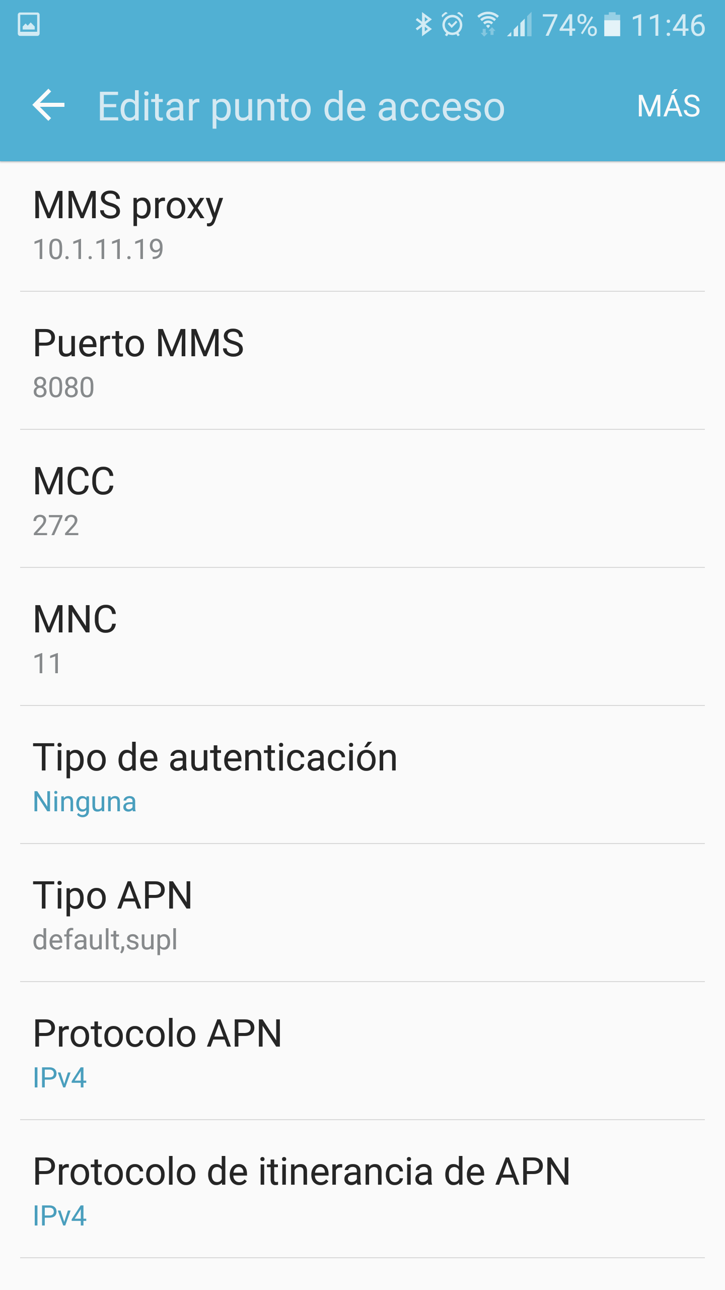

the below are the screenshots:
picure 7 shows the to 2 connection settings: internet and MMS
pictures 6,5,4 are the MMS settings
pictures 3, 2, 1 are Internet settings
I tried with APN with:
default,mms,supl
and
default,supl
as I saw mms is in the MMS connection
Here are the screenshots: for Internet and MMS (I have the settings in Spanish, but the fields are the same)
Screenshot_20161026-114629.pngScreenshot_20161026-114622.pngScreenshot_20161026-114612.pngScreenshot_20161026-114549.pngScreenshot_20161026-114541.pngScreenshot_20161026-114535.png
Try changing Authentication type to None/not set then reboot.
It actually had no connection at all.
I went to MMS settings and I deleted it as I do not expect multimedia messages nowadays.
I then added mms in APN type in the Internet connection
Now internet is working perfect, page loading instantaneously (before it was opening in 5 to 10 secs or not even opening)
I think the issue was the MMS settings, probably installed by 1 of the tweaker messages
thanks so much for your help.
