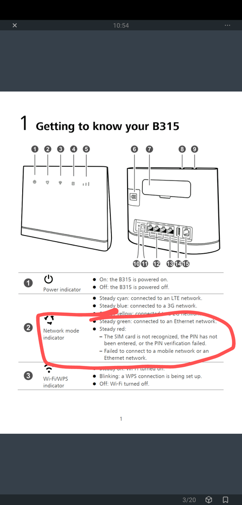

Re: Card not working in router...
Posts: 17,776
‎08-09-2022 10:56 AM
Strange, the manual says this...
